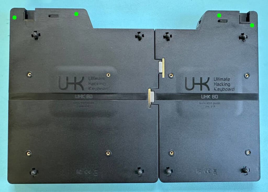

This guide describes how to disassemble your UHK 80, which is especially useful for replacing your case with one of a different color. Let’s do it!
You’ll need a keycap puller and a PH0 screwdriver.

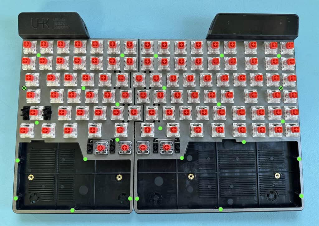

Remove the keycaps with the keycap puller and unscrew the marked screws. Also, remove the palm rests and cages.
(The screw holes with the X in them contain a spring between the circuit board and the metal plate. Put them back if you also remove the switches and separate the circuit board from the plate. Before reinserting switches, make sure to put the circuit board back into the case; otherwise, you can rip off the sockets!)
Unscrew these screws to be able to remove the top case parts on the front side.
